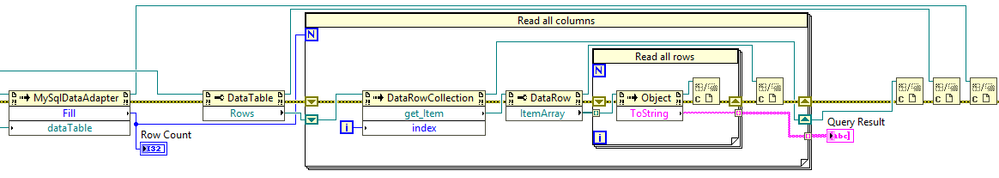

Hello Nick an Wiebe,
Here is example code I am currently working on. It retrieves all information stored in a DataTable that came from an SQL query.
This code is working, however it's work in progress. I am currently installing a new MySQL server to be able to wireshark the connection to verify it is actually doing exactly what I am expecting.

So,
Here is the promised full code. I created this example for Nick. What is special about this code is, that it does not rely on LabVIEW Database Connectivity Toolkit; due to MS drivers used in that code that only exist in 32-bit, this toolkit is not available for LabVIEW 64-bit. Therefore using e.g. .NET is necessary to connect to a database with LabVIEW 64-bit.
Nick was using a MySQL database (see his VI attached above), however my example code should work with MS SQL and other SQL database systems in a similar fashion.
For this example, I was using MySQL Community Server 8.0.12MySql.data.dll from MySQL Connector/NET 8.0.12, and the example database "Sakila" that comes with the server.
My examples convert all data to strings, as this way it is possible to dynamically define a query. Only using a predefined query with known result column types one can define the type(s) to use during edit-time of the VI. To come around this limitation, one can of course use the variant data type.
Attached are two different versions; one that iterates through all results on the server, and one that writes the query results to a DataTable and transfers this table to the client all at once. Both are attached as LabVIEW 2017 and 2014 versions.
Keep in mind that this is example code I created, so it's mostly untested. Do not use it in production environment or with sensitive/important data before testing it thoroughly!
