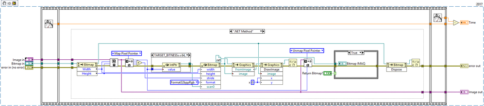

You just made my week! The IntPtr had come from an example I had found from like 2011 and I just accepted that it was the thing to do without really questioning why. Also the method doesn't visually specify that it's of a specific type, so I never considered looking at it.
Well I'm happy to present this code for any who may need it:BitmapToIMAQ.pngBitmapToIMAQ.png

I've actually made a couple changes since. The format going into the IMAQ Bitmap has to be the same as the imaq itself, not of the source bitmap. Also I added an option to return the IMAQ Bitmap reference since I have some potential need for that as well.BitmapToIMAQ.pngBitmapToIMAQ.png
