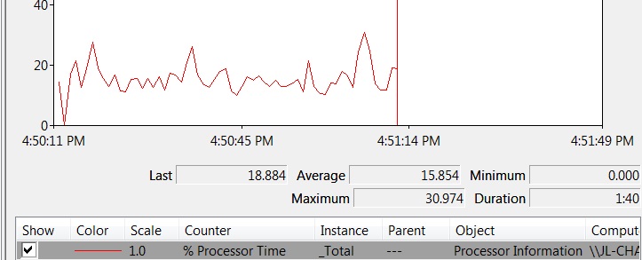

In this most basic example that Dave wrote, we are trying to access total %cpu... as you can see in the attaced jpg... It works fine from Perfmon on the computer in question... but the VI still throws the 1172 error.

Just to be clear, flipper66 and I are working on the same system, so his observation that the perfom works but the .NET VI doesn't is specifically in reference to the troubled systetm.
Despite his observation, it would still seem likely that there is some issue with the target computer and how certain .NET things are installed.  Is there a way to re-initialize or re-install the relevant NET components on that computer?
