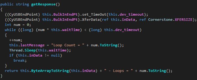

I had a look at the source for the "bool setWavelength(double wavelength)" method I can see that it could be a communications or compatibility issue with the device:
  • It enables a handshake and waits for a response (this could take up to 500ms - waitTime = 10ms and dev_timeout = 500ms)
  • It sends a command "GOWAVE xxx" where xxx is the value you provided. If there is not a reasonable response (a response that starts with a '0') or if there is no valid response then it could wait a long, long time to get said response. I suspect that this is where you are getting stuck.
  • It disables a handshake and waits for a response (this could take up to 500ms)setWavelength methodsetWavelength method
    getResponse methodgetResponse method
However it does also have some measure of debugging built in, provided another thread can be spared to do so. It appears as if debugging messages are pumped to an internal field "lastMessage" and retrievable through the getLastMessage method. The messages are not buffered and are overridden as a new one is created, so it is important to retrieve the latest message before it is overridden.
getLastMessage methodgetLastMessage method
If you have Visual Studio (Community version would suffice) then you could use that to debug the call provided you have installed a dis-assembler. Otherwise, if you have just LabVIEW, then you need to set up a crude test so that you can call that getMessage method in parallel to your other setWavelength call, retrieve the last message (string) and save that into a buffer so that you can look at the entire history.
