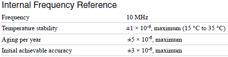

Your two devices are operating using their own separate internal references, and each device has its own small frequency error. I don't have an NI5663e. I got this spec for the internal frequency reference for a PXIe-5663E VSA from its users manual. At 200 MHz, your 100 Hz offset is 0.5 ppm and is well within spec, so I don't think your device is broken.

About the internal frequency reference. You seem to be right .. but then it is realy not a good device ... We also have a NI6674t module which has a very good clock (ocxo) with a accuracy of 80ppb (http://www.ni.com/pdf/manuals/377485a.pdf, p4). I tried to use it for the 5663E. I routed this clock to the PXIe backplane and set the RFSA set reference clock to PXIe backplane. This reduced this offset to 60 Hz.
60 Hz / 200 MHz = 0.3 ppm = 300ppb. The OCXO clock is referenced with a accuracy of 80 ppb. So I gues there is another way to use the ocxo clock for the 5663e?
