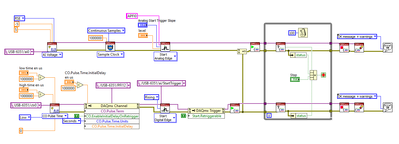

I've just created a digital output trigger from an external source with a positive value [0;5V]. It works very well (see picture, in yellow the external signal and in blue the triggered signal). Now I'd like to get the same answer, but with a negative external signal [0; -5V]. Do you have any ideas? Because I'm trying to integrate the "Start Analog Edge" function instead of "Start Digital Edge", but it's not compatible with the rest of the program chain ....

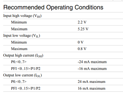

The digital TTL is always 0 to 5V. From NI 6351 Device Specifications,
Either you use the analog edge trigger, or you use an external circuit to invert the voltage.

I think this idea is good .... for the analog trigger, are you talking about APFI 0?
I tried but something doesn't work .... Did you see vi with my message? Can you help me modify it?

I've found the solution!
I use a digital trigger to process an analog signal ....
I use AFFI0 and "start digital edge" function
