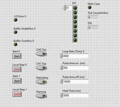

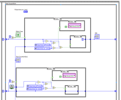

This is the FPGA code that control de inputs and outputs:
I think that this pulse time on and off need to be the same or more frequent, when i've tested with pulse times of 10000ms in both the green led for DO1 or DO2 are similar to the others. I made a quick test based on the code for the DO7 which is a bit different.
But now when i'm deploying the new FPGA code it runs in RT with the old values of pulse time on and off. Do i need to format the crio to put a new configuration? It's better to change that pulse times to a constant?
Thanks by your time and help, you two are always here to help!
