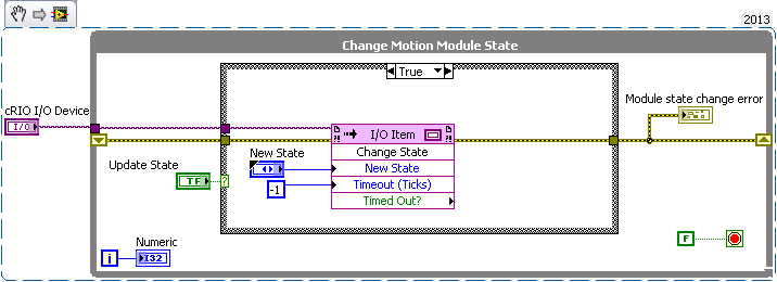

Module State Control
This loop simply controls the 9512 module state.  When the update state Boolean control is false it simply iterates through an empty case.

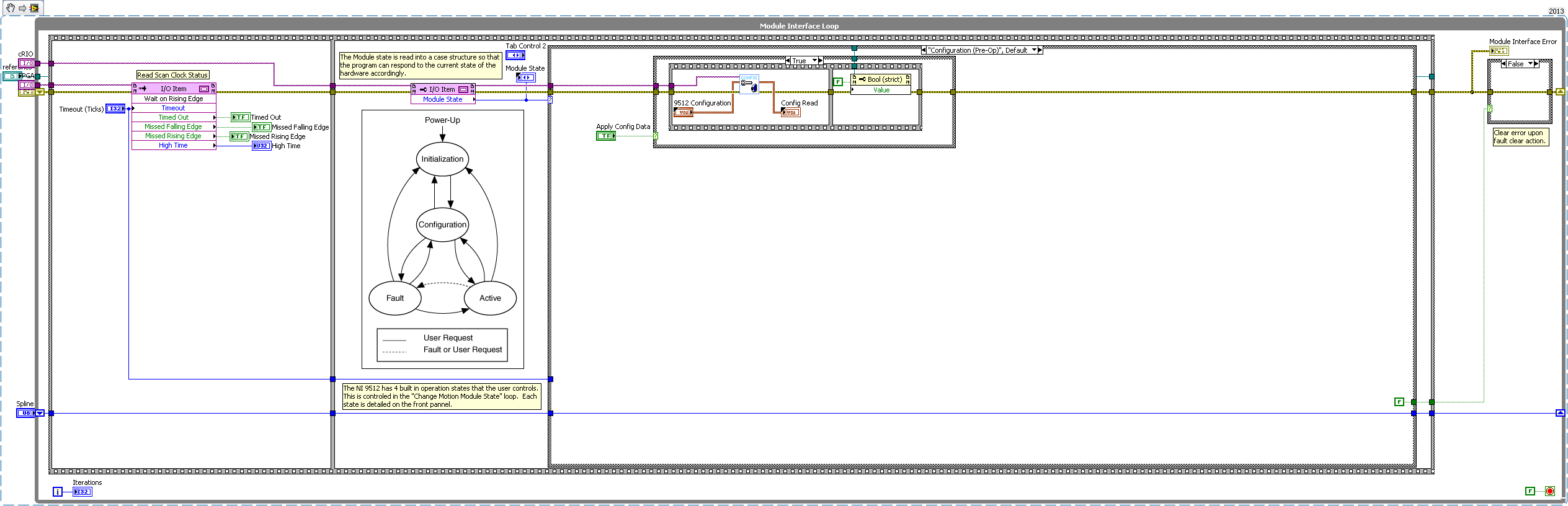

Module Interface loopThis is the loop that actually writes information to the module.  The inserted diagram shows the possible module state transitions for reference (I have also attached the image for easier viewing).
The image above is currently showing the configure state which simply controls module settings.  The initialize state remains empty because no settings can be changed while the module is in initialization mode.  I also combine the active and fault (safe mode) cases which simply write to the FPGA write buffer scan values to module and then read the updated values.
Any input would be greatly appreciated I've been hitting my head against a wall trying to get this thing to work.

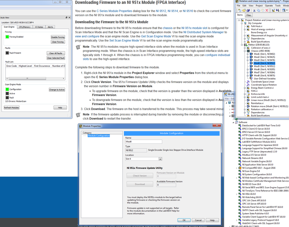

I have exact the same problem with my NI 9512 module. Was this problem solved somehow? If yes, please share some tip how to make it work. How to solve this problem with time synchronization fault. I wondered, if I need to update firmware on my NI 9512, but I can not even make this done. Everything is set according to guide, but Firmware update utility doesn't respond.
Thank You for any answer.
Firmware updateFirmware update
