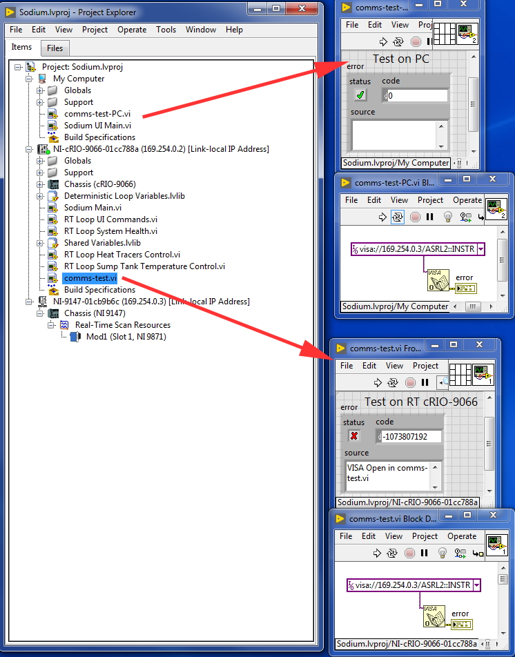

getting error -1073807192 (VISA: (Hex 0xBFFF00A8) Access to the resource or remote machine is denied. This is due to lack of sufficient privileges for the current user or machine.) when accessing serial port/resource on second cRIO chassis with NI-9871.
Accessing the port from desktop PC works fine.

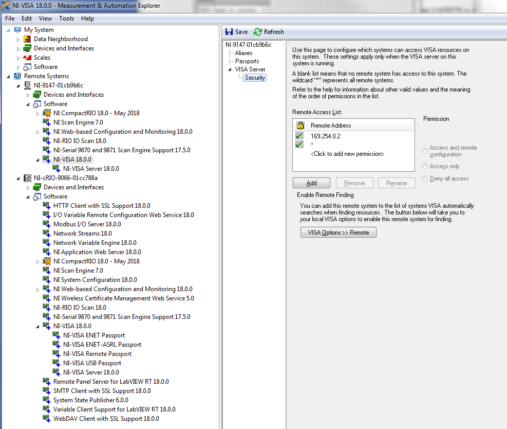

I have checked and all the settings in NI-MAX, installed latest NI-VISA Server on both chassis.
Can see the ports in NI-MAX.
Both chassis in scan-mode.
Have checked NI-VISA Server permissions, even added individual IP addresses, even tried new users.
See snapshots below:
NI-MAX ConfigNI-MAX ConfigLabVIEW ErrorLabVIEW Error

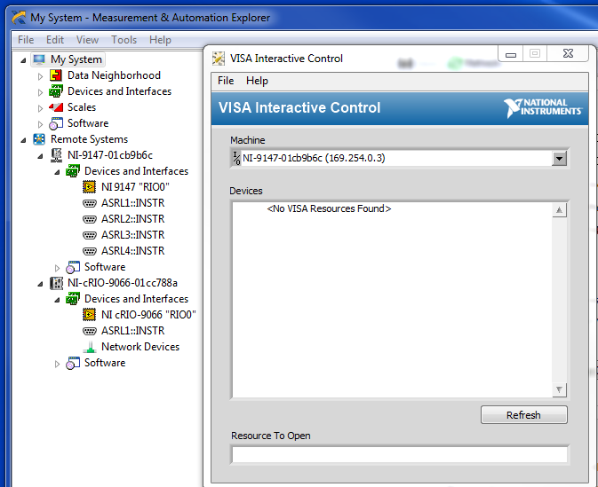

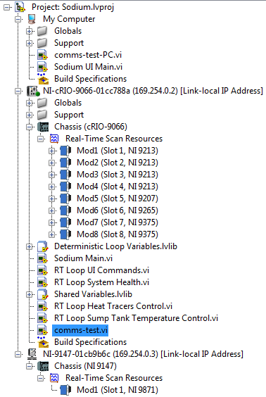

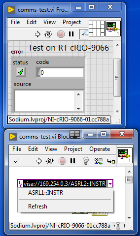

Thank you for the reply, below are snapshots with details.
In short, the four com ports from NI-9147 show in MAX but not in the VISA test panel or the LabVIEW diagram (had to type in the address and resource name manually).VISA-list.png

Problem solved, access/permission granted!
Here is how to fix the -1073807192 error when accessing second cRIO from cRIO over one Ethernet:
I have reconfigured everything to the second local network (second Ethernet card in my PC) 169.254.0.x.
Manually edited /etc/hosts on both cRIOs (see below).
Rebooted both cRIOs.
Now have access!
