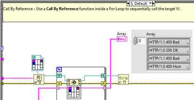

Can you try running this example on your system:
[LabVIEW 20xx]\examples\Application Control\VI Server\Asynchronous Call By Reference\Benchmarking Asynchronous Calls.vi
This example has nothing to do with AWS, but it does send HTTP GET requests to various URLs via raw TCP calls. Before running the example, though, create an indicator that displays the return values for the GETs:
If this example works fine (i.e. if those strings display valid HTTP responses), then there may be an issue with either the HTTP API or something AWS-specific. But if this example doesn't return any responses for the GETs, then your system has a fundamental network connection issue. Perhaps you need to investigate your firewall settings to ensure that LabVIEW isn't blacklisted?
