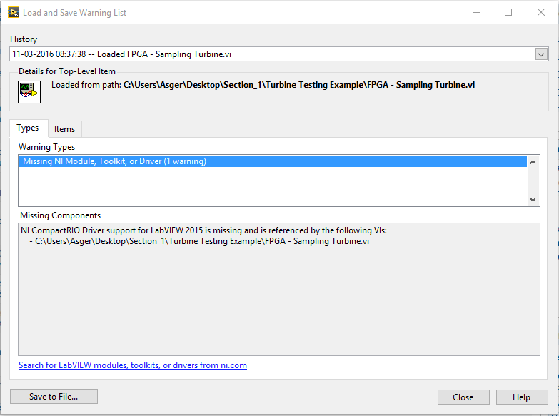

I have a NI cRIO 9038 that i wish to use for a project, but i keep having incompatible software issues. I've downloaded both LabVIEW 64-bit, CompactRIO 15, Xilinx FPGA tools, NI FPGA Module and then LabVIEW 32-bit. All those components are updated in the NI Service Manager.
I'm trying to learn how to use this device, and I'm going through the guide of https://www.ni.com/en/shop/compactrio/compactrio-developers-guide.html where the first example is a Turbine including different VIs. When opening the files it succesfully scans and loads all required sub-VIs, but just upon opening i get the following error message

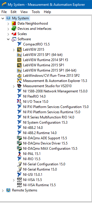

Here is a view of the installed software in my MAX

How can i solve this issue?

Do you also have LabVIEW Real-Time and LabVIEW FPGA installed? You probably need to install those before the CompactRIO drivers. I'm not sure if LabVIEW RT/FPGA is supported in LV 64-bit - it doesn't look like it's showing up under LV 64-bit in your MAX screenshot.
Edit: Sometimes the installation order can be important - LabVIEW/FPGA/RT first and then the CompactRIO drivers - you might want to do a reinstall and see if that sorts it.
