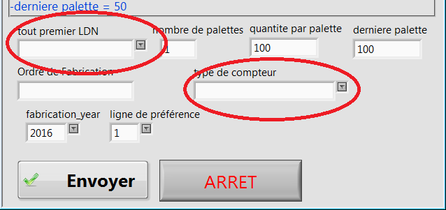

I have to create a control that uses enums and ring controls (see images joined) and establish a link between the two lists.
xcontrol seems to be the best solution but is very complicated do use, I wander if someone can help me...

my purpose is to display an interfacein which my two commands are included (red circles). the architecture is powered by user event on the button "envoyer" consequently, I cannot easily make the commands changing interactively one another
the enum "tout premier LDN" force a particular value in the ring control "type de compteur" and enable/disable selection
the first solution was eventualy a xcontrol composed of these two controls
the second solution would ba a parallel loop and lists updated by properties nodes
any idea?

Unless the display of this configuration options MUST be part of a bigger panel i would simply create a popup dialog with that UI. I wouldn't bother with XControls in that situation.
That being said, the XControl CAN provide what you want to have but still you have to consider the XControl as a complete separate panel development-wise.....
You can use the Init ability to update and sync the XControl to available default settings. I recommend to read that from a file and store the complete data set in your XControl. As you obviously have a general idea how to create the link between the rings, that part should be quite self-explanary to you....
