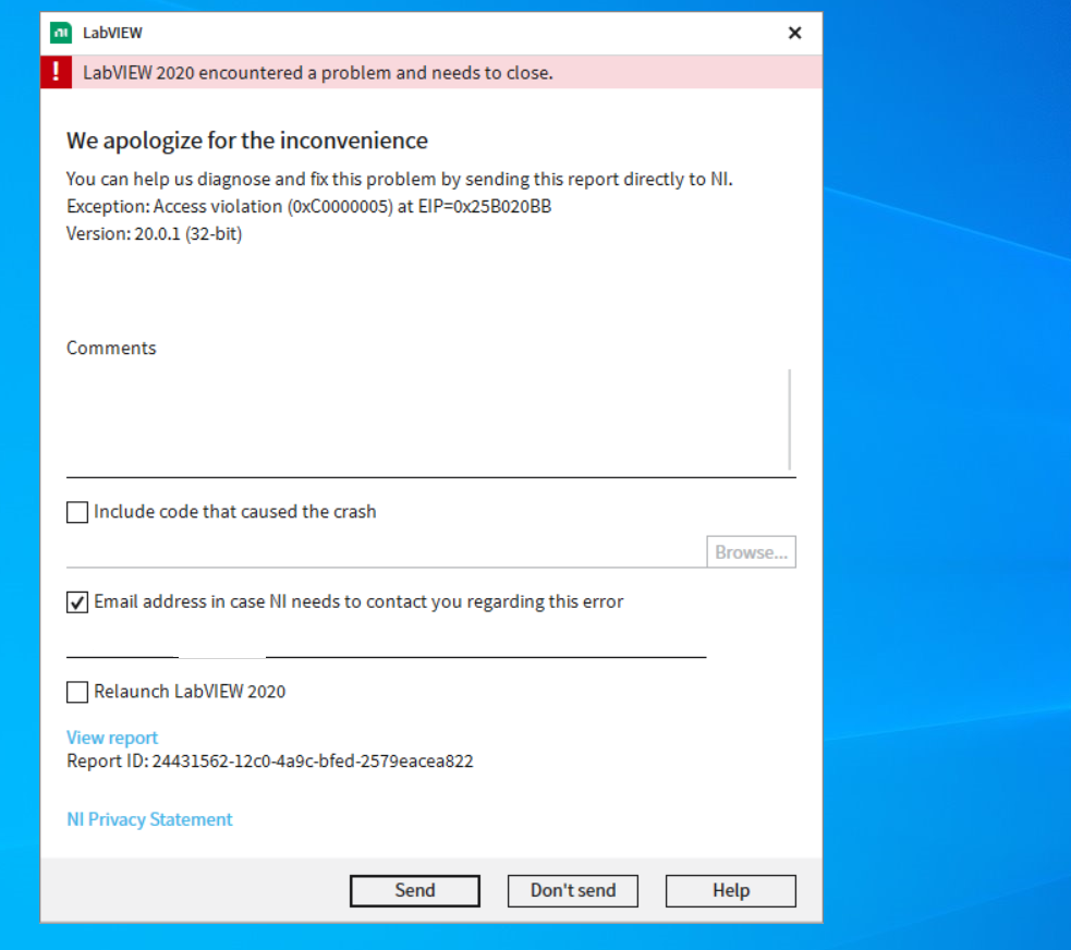

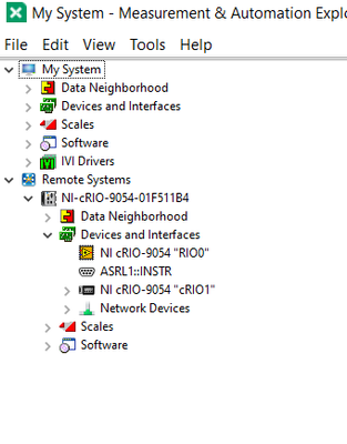

I am facing a strange issue with NI Device monitor utility. NI MAX is frequently crashing upon opening and I am not able to detect any device in NI MAX and Not able to use CompactRIO target in the LabVIEW project.

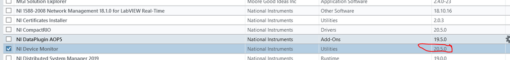

I tried to reinstall everything including NI System monitoring to LabVIEW and device drivers using NI package manager but no help. I also updated the NI Device monitor utility in the NI package manager but doesn't solve the issue.

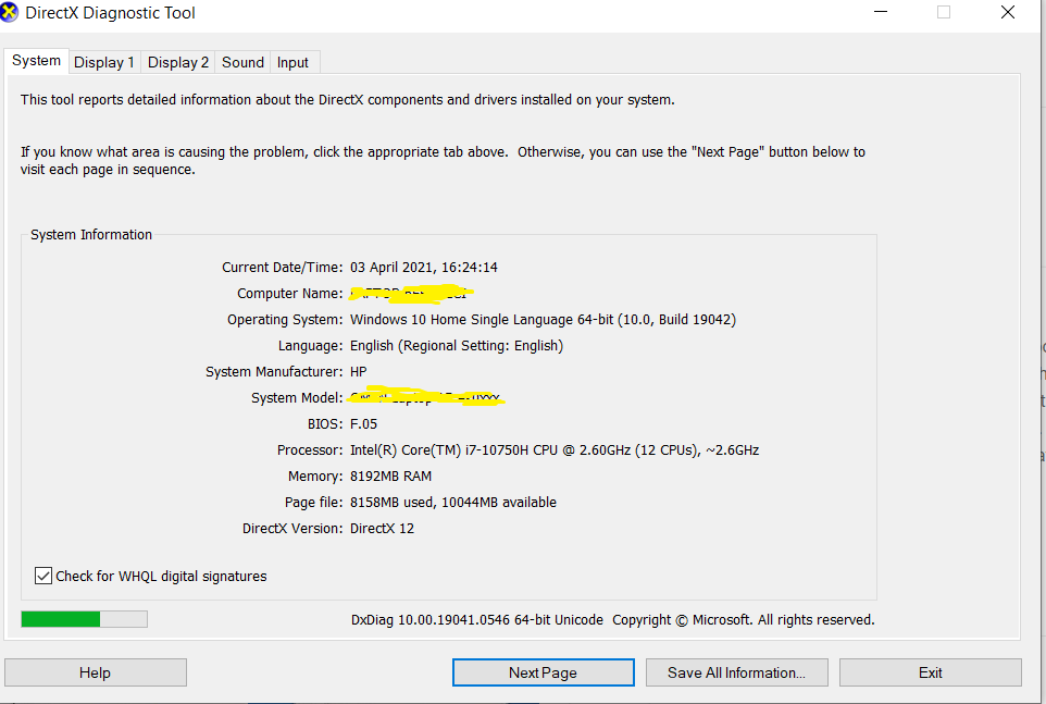

I also updated DirectX using Microsoft DirectX web utility but no help.
PFA, Screenshot. Any idea? NI device monitor app crash.PNGNI device monitor app crash.PNGnoCapture.PNGCapture.PNGlv crash.PNGlv crash.PNGni package.PNGni package.PNG

Hi Bob,
1. LabVIEW 2020 32bit version is installed. On my PC only this version is installed currently.
2. This issue occurred 2 days before, when I tried to launch NI MAX suddenly everything started crashing.
3. The NI MAX screenshot I posted is just after I repaired NI System Configuration from the NI Package manager. So, it opened but didn't show any software installed, and the Keeps showing "refreshing" as it kind of stuck in an unknown state.
I also tried the Reset Configuration in NI MAX assuming it will solve the issue but no help.
4. I did everything, right from uninstalling LABVIEW 2020 and all device drivers. Then after reinstalled everything but still the problem is not solved yet.
5. I checked on my other PC where NI Device Monitor 19.0 version is installed, it's running fine.

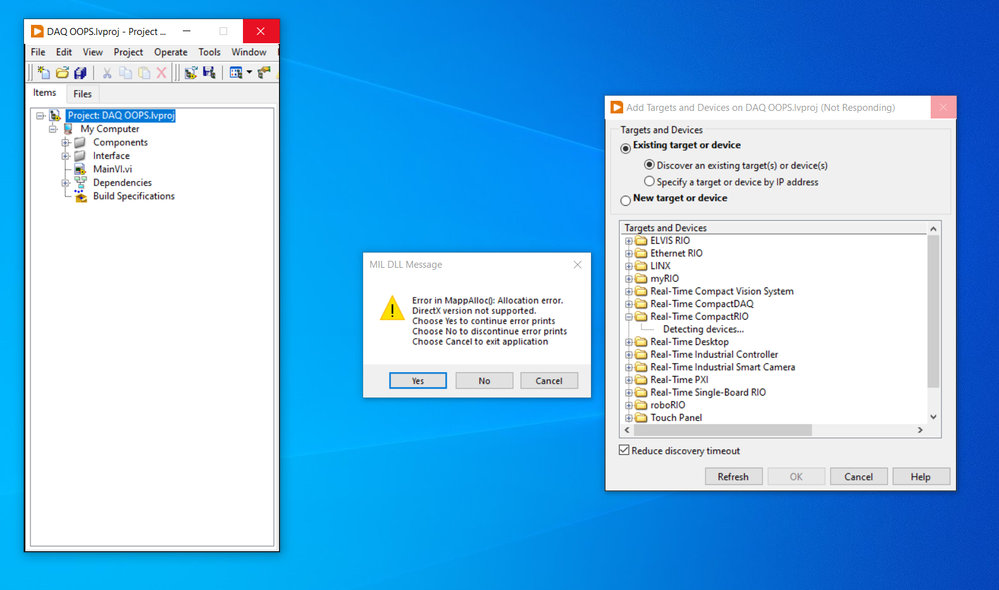

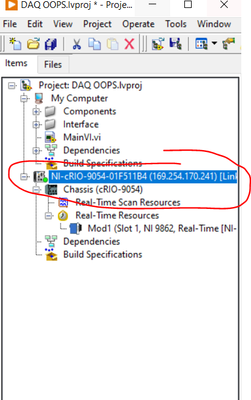

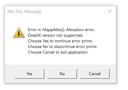

Seems like, this problem is mainly because of the NI device monitor utility (v 20.5 installed now). because of it, I cannot add CRIO or any other target to my LV projects. If I try to add CRIO9054 which is currently connected to PC in LV project, LabVIEW crashed and shows MIL DLL error dialog and Access violation error.

Hi bob,
This issue is resolved now.. with a bit of web search I found that mill.dll file is missing from C:/Windows/System32 and /SysWOW64 folder.
After restoring it, NI MAX is working fine, and am able to add the CRIO device to my LV project and able to detect all the devices.
solution link - https://www.dllme.com/dll/files/mil_dll.html
I hope this solution will help others if they stuck with the same error.
Don't know what update caused this file to get deleted. maybe because of any windows update.
