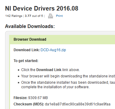

However, i was unable to find exactly the same installer as http://www.ni.com/download/ni-device-drivers-august-2016/6262/en/ doesn't provide a download link.
For me it shows a download link:
Maybe you should login to the website with your user account?
