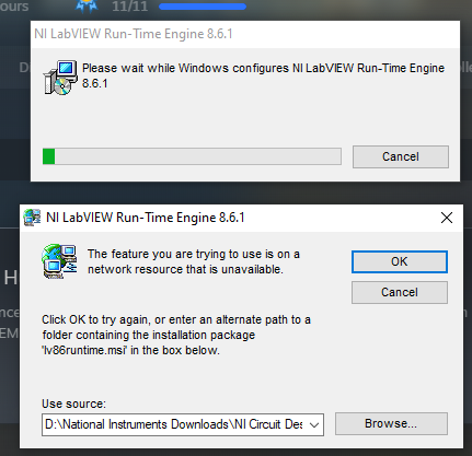

Now, my issue isn't exactly concerning a National Istruments software but rather, the damage it has caused to my computer. To put it simply, after I deleted the files of NI(because the uninstaller wouldn't work for whatever reason), it started interfering with a completely unrelated program. More accurately, it has somehow managed to hijack the executable of a game development software that should in no way be related with NI, making it impossible to launch it by having these 2 windows pop up:
I was completely bewildered. How is this software that should no longer exist in my computer be affecting this unrelated program in such a malicious way? As you can see it requests some file that of course doesn't exist because I deleted nearly everything relating to NI LabVIEW or whatever. No matter what I did the software couldn't run because of these 2 that wouldn't go away without me having to go to the task manager. Afterwards I tried disabling all NI services in msconfig but to no avail. After that I decided to delete every single registry file and while that still did not work, it reduced the problem to just having this window pop up:

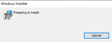

I've no clue what the hell it's preparing to install... No matter how long I wait or whether I cancel, it still does not do anything. I have to go into task manager to get rid of this.

The second message is looking for "NI Circuit Design .....".   It was probably a secondary toolkit or module to be installed, and it is looking for it on a 😧 drive.  Perhaps when it was originally installed, it came from a drive called d:\ but that drive doesn't exist anymore.
What is this "game design software"?  Where is it from?  Perhaps you need to try reinstalling it.  If it is built in LabVIEW and installed toolkits it needed to run (even though you think it wasn't), and you removed those things because you were getting rid of LabVIEW, you might have just cut out the things that the other software was also using.
