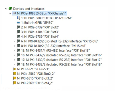

I have two Ballard Arinc 429 cards in there, but I don't see them listed on NI Max.
Should It be there?
I was told that since it's a Ballard card and not NI. It will not show up on NI Max. Not sure what to believe.
any advice would be appreciated.

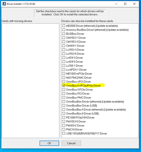

To access the cards you first need to install the PXI drivers for the card provided by Ballard.
Find and download BTIINST64-DRIVERS.EXE or BTIINST32-DRIVERS.EXE go through the usual licenses and do you really want to do this screens, if the PXI rack is connected and powered on it should then autodetect and self identify your cards and tell you what drivers to install else manually tick the OmniBus II cPCIe/ PXIe Driver.
I found the picture below in my notes.

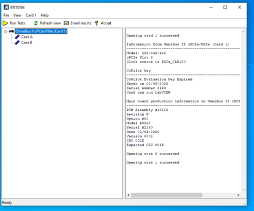

Once the drivers is installed, you then need a program called “BTITST64-TEST" or “BTITST32-TEST  to launch the Ballard OmniBus II test program, this will allow you to actually see your card in the PXI rack and get some small feeling off "yep it is actually there :-)"

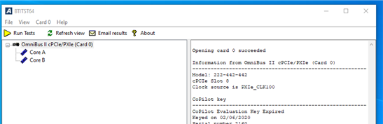

Here you can see the PXI slot the cards are found in for each card. Note the Card numbers as that is used by the API to talk to the correct card when programming with them, I think they defaulted  both to the same number Card 0 so you may need to change one of them if that is the case.
