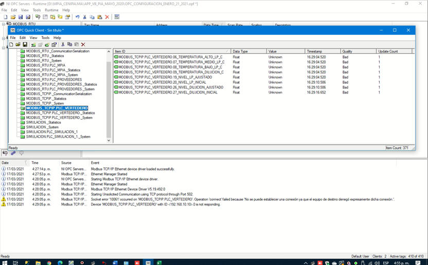

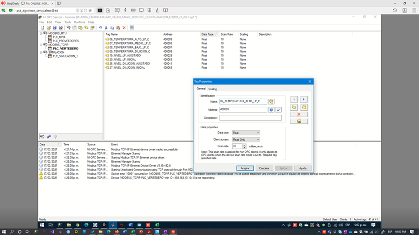

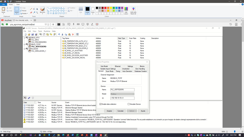

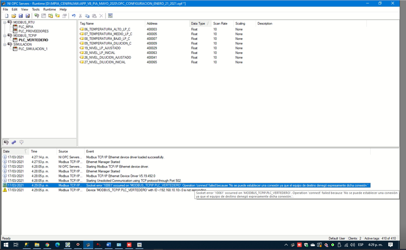

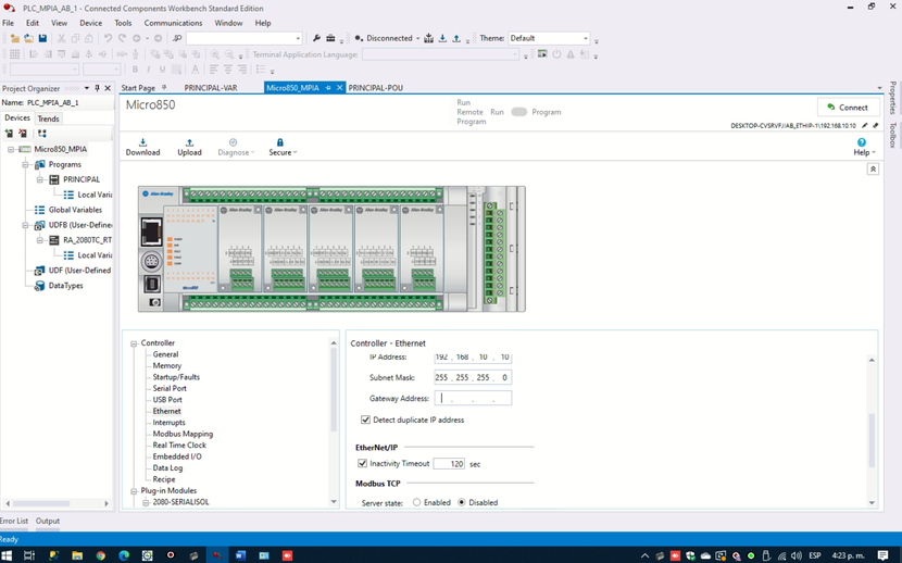

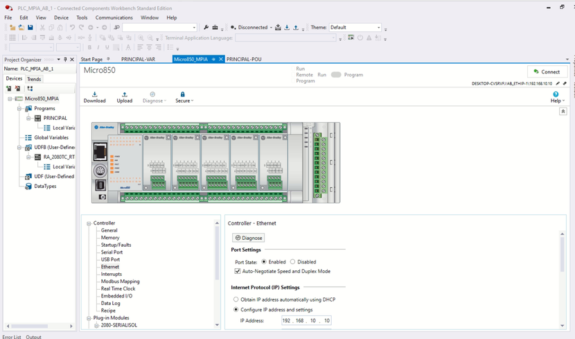

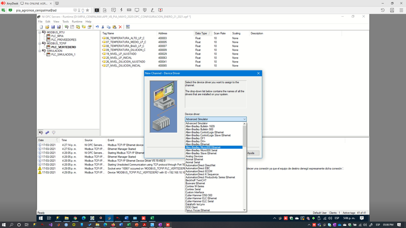

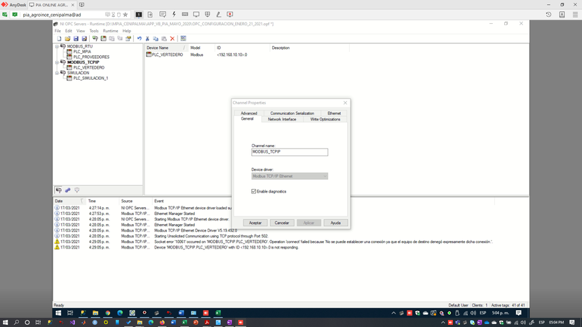

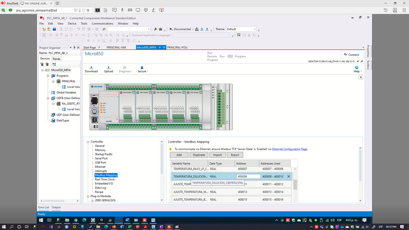

I have a similar problem when I try to connect a Allen Bradley Micro850 to a PC and other equipments by OPC Server using TCP/IP protocol.
I attach the configuration of PLC and PC with OPC Server.
PLC configuration:
OPC Server configuration:
Can I use this driver? (Modbus TCP IP Ethernet) or I must use the Allen Bradley Micro 800 Ethernet??
This is the last configuration
This is another configuration that I have tested but it doesn't work.
Thanks.
