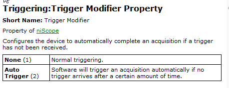

Did you try auto trigger?

Auto trigger makes no difference.
