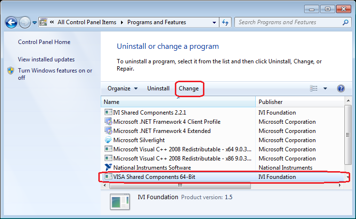

I do think you'll need to reinstall NI-Sync. It sounds like the PATH variable is missing some VISA paths and possibly IVI paths. I would recommend repairing the VISA Shared Components installation to fix the VISA paths:
  1. On your system, navigate to Control Panel\All Control Panel Items\Programs and Features.
  2. Click on VISA Shared Components 64-bit.
  3. Click on the Change button above (see image below).
  4. In the installer setup, click Next.
  5. At this point, you may be prompted for media. If so, follow the instructions.
  6. Click Finish.
  7. Now you should be able to use NI-Sync VIs in LabVIEW.
Option two - You could manually add the VISA and IVI paths below to the PATH environment variable, but I would not recommend this.
