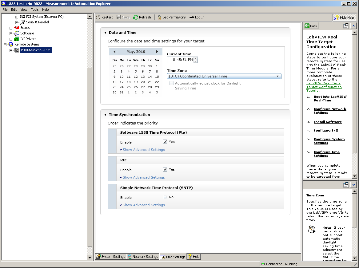

Hello KeithLV,
As for configuration in MAX it looks like you should be able to see something like figure 2 in this article below.
Timing and Synchronization in NI LabVIEW - https://www.ni.com/en/shop/labview/timing-and-synchronization-in-ni-labview.html

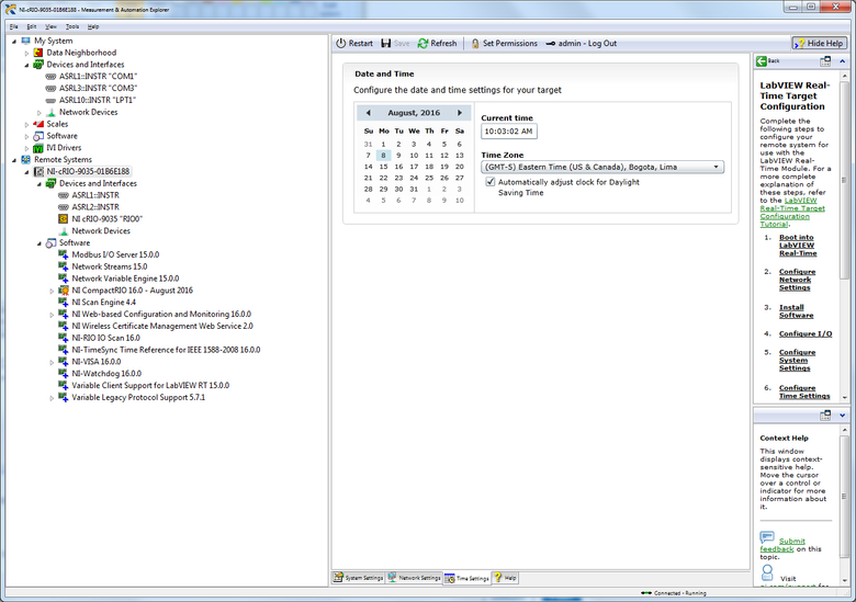

JY,
I am not seeing the picture shown in figure 2 of the article: https://www.ni.com/en/shop/labview/timing-and-synchronization-in-ni-labview.html
I attached a picture of what I see in MAX under the network configuration settings.
This is what I should see in the Time Synchronization Properties in Max under the cRIO-9035 hardware. (https://www.ni.com/en/shop/labview/timing-and-synchronization-in-ni-labview.html)

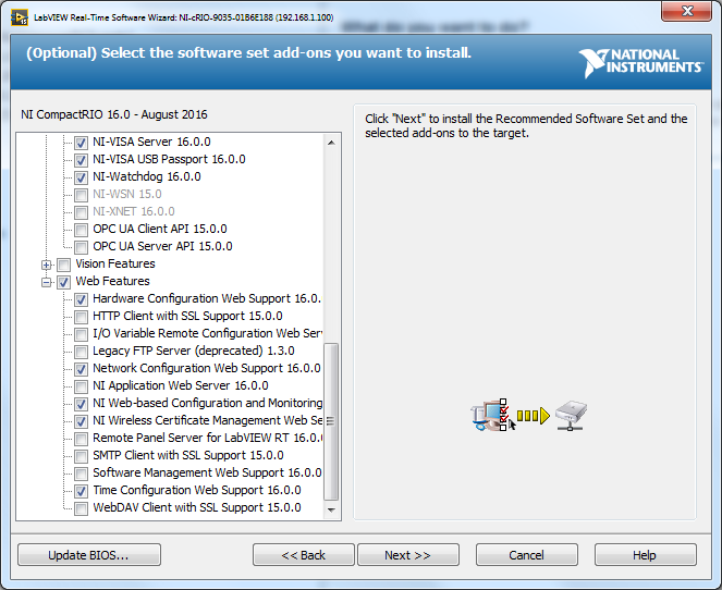

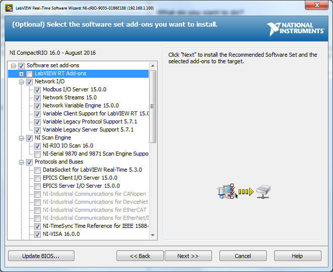

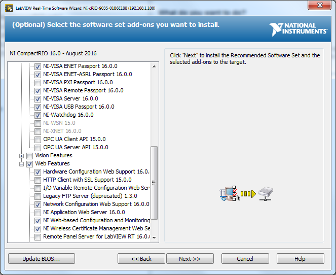

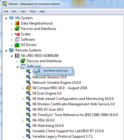

This is what I see for the Time Synchronization Settings (I cannot enable NI-Sync nor enable 1588 protocol):
1) Is there a reason I do not see the NI-Sync settings??? I believe that I have TimeSync 16.0.0 installed.
I am not using EtherCAT, so I do not think the other article applies in my case.
Regardless, I am dumbfounded that I cannot see the NI-Sync settings with LabVIEW 16.0.0 and NI-TimeSync IEEE 1588 installed.
2) Should I have other Time packages loaded on the cRIO-9035 in order for the NI-Sync settings to show up?
What I have installed so far on the cRIO-9035:
