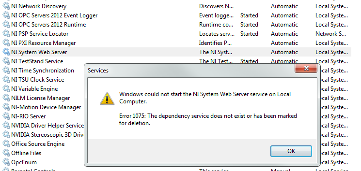

I'm getting the NI System Web Server Not Running message when I try to run examples, etc.  Previous threads have suggested that performing a repair on the LabVIEW installation should fix this, but after two attempts, sitting here for quite a while feeding DVD's in, still it is giving me the same message. When I tryi to start it by hand, per the suggestion of one thread, I get the message, "Windows could not start the NI System Web Server service on Local Computer" "Error 1075: The dependency service does not exist or has been marked for deletion."

when you say you are launching the server by hand do you mean from the Window service list?
According to Windows NI system Web Server depends on NI Service Locator:
is Service Locator up and running?

I'm running into this issue now after installing LV 2012 SP1.  I uninstalled LV 2012 SP1, but unfortunately my services are still broken.  I've repaired LV 2012 and it hasn't helped anything.  I'd rather not uninstall LV 2012, but it's looking like maybe I ought to.

When you say your services are not working - are they shown in the services manager? Can you restart them from there?

I've found documentation that suggests you may receive that error if your version of the Run-Time engine does not match the version of LabVIEW you are running. I would make sure that you have the correct Run-Time engine installed.
http://digital.ni.com/public.nsf/allkb/A30D52E46877EE7A8625778B000BAA30?OpenDocument
I've also found documentation for similar errors says that repairing the install should fix it. The following knowledgebase article suggests this except the service we are refering to was installed with LabVIEW and not Measurement and Automation Explorer.
http://digital.ni.com/public.nsf/allkb/A05913DE561AB739862579F7005C4F81?OpenDocument
I realize you already tried to repair the install. I am just not sure yet about what further steps to take at this point. Most of our department is out of office for the holidays. If you are still having this problem on Monday, I'd be happy to ask around further.
