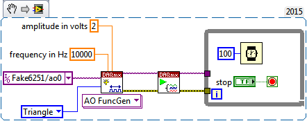

This snippet should let you try testing it with LabVIEW instead of what you're using now.  (changing the 6251 reference to actual device name and output that you're using, of course).  I don't have an actual DAQ in front of me to make 100% sure though.
