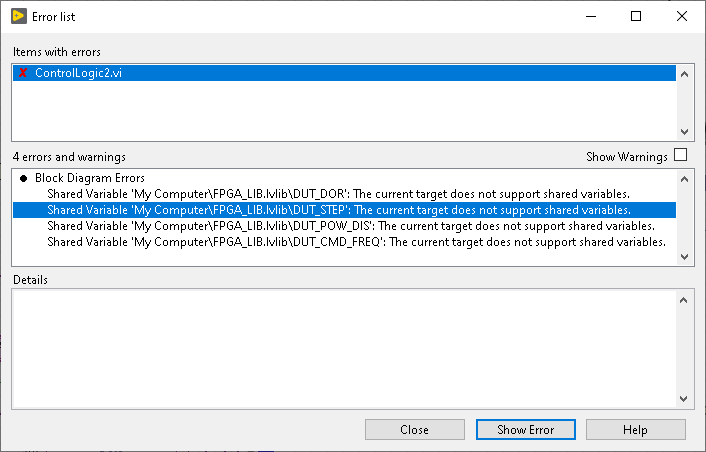

I'm trying to share a few boolean values between a host application and an FPGA using shared variables. However I get the error when trying to build:
I can't seem to find much info about this error, or why the NI USB-7855R doesn't support the SVE.

FPGA does not support Shared Variables.  You can just use front panel controls to pass tag data to the host.
