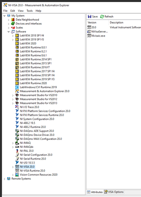

You should have NI-MAX installed.  Run it and post an image of the Software tab.  Mine looks like this:
You should have NI-VISA 20 if you got it recently.  It should work fine with LabVIEW 2019.  If that is there then I suggest you also install NI-Serial 20.  I have found that sometimes LabVIEW complains about missing VISA components when it already has them an actually needs something from NI-Serial or NI-488.2 (GPIB).  I usually install them all on any PC I plan to run LabVIEW code on.  You can get them here:

i have attached a picture of ni max below .any other ideas i should try?

It looks like you have everything properly installed as far as LabVIEW is concerned.  I put the error code in on the ni.com/info site and it provided a list of possible issues:
Problem Updating Feeds When Installing Through NI Package Manager - National Instruments
Almost all of them are problems with downloading into the Package Manager.  Things like your firewall settings, anti-virus, VPNs, etc.  Have you looked at that list?  Are you working for a company that has an IT department that might help?
