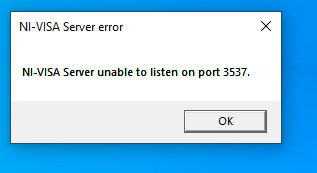

NI VISA error
 What does-it mean?
(2,555 Views)
I don't have complete information nor operational knowledge about NI-VISA Server, but AFAIK and can guess it is an application (maybe a service) that allows programs running on other LAN nodes to control instruments by means of VISA as if the instruments would be directly connected to the client PC. NI-VISA Server listens for client connections on TCP port 3573. But on your computer there is already a program or service that uses this port. Hence the error message. If you have installed VISA Server but don't want to use it, you may simply uninstall it.
Could it also be due to firewall blocking?

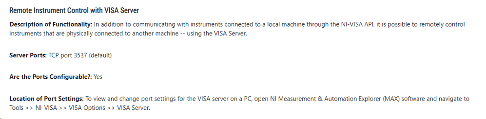

@Bill, you're correct, it is a port used by NI-VISA and it must be open.
https://knowledge.ni.com/KnowledgeArticleDetails?id=kA00Z000001DdxbSAC&l=en-US
https://www.ni.com/en/support/security/configuring-software-and-hardware-firewalls-to-support-nation...

@billko  ha scritto:
No, because applications know nothing about blocking. Actually, the firewall (nearly?) always blocks connection attempts coming from other nodes. Another program on the same machine would be able to connect.
