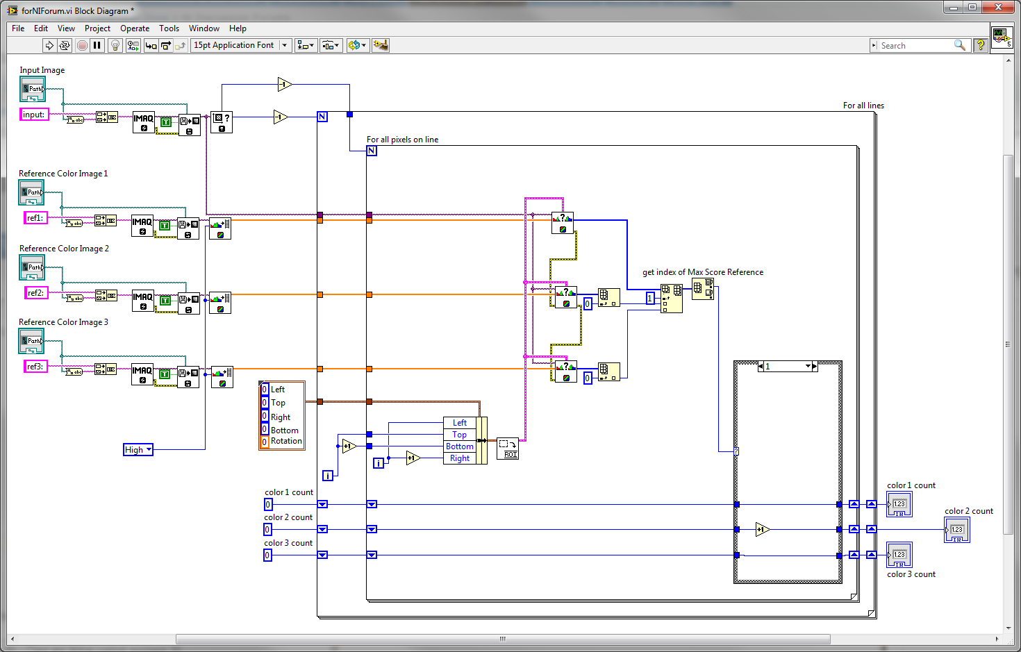

I need to calculate the area of certain colors in an image.
The colors are not pure RGB, and are very close in the HSL and RGB color spaces.
I have struggled to find good ways of detecting them, so that I could calculate the areas, but yet I have not found a method that can match the colors as well as the build in LV_ColorMatch() and LV_ColorLearn combination.
my problem is that I cannot do it fast enough.
The colors represent different layers of a material, that is randomnly damaged, as a result the areas that I am looking for occurs unstructured. The camera resolution is matched to the task, so that 1 pixel after bayer bilinnear colour estimation represents the area resolution the customer is looking for.
The images are precaptured and the ROI is found by the capture system, that produces the images for this vi.
The input images are 3000w by 300w [px]
when I attempt to do it like this double for loop, I have to iterate 300x3000 times ~900'000 times - and that takes about a minute.
However I need to do this in about 3 seconds.
The image below contains a screenshot of a simplified version of my software, that illustrates the algorithm that actually works well enough to provide a decent count of target colours.
(I know the mm/px ratio in both axis, so I can multiply the count with that and get the area)
This is very frustrating as the build in histogram / historgraph uses a few milliseconds, and even though they only look at 1 colour space, I guess they must access the image data in another way than the double for loop pattern.

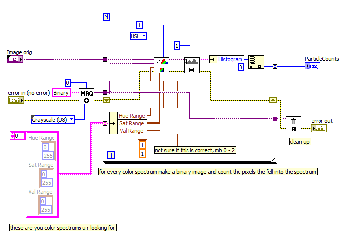

Zcuba, do not hijack other threads !!
As a rule of thumb, if you are looking for a region (different layers of material) first figure out the region !
You are using functions, that will give you the result, but as you figured out, it takes loong.
Your source code can be replaced by faster alternative using IMAQ color treshold. You should get your 3 seconds.
If you dont fancy HSL, just use the RGB model. For images of your size, the treshold should run in about 50ms (guess).
Try something like this :
Message 7 of 10
(7,352 Views)
