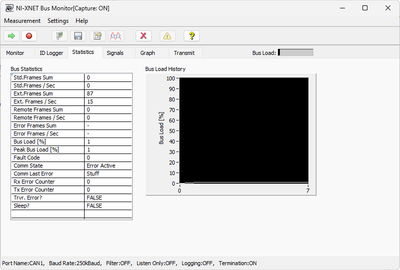

NI-XNET Bus Monitor
Does anyone know if NI has any drivers that can grab these statistics tables?
(744 Views)
Use XNET Read (State CAN Comm) VI for fault-related info.
See CAN Bus Load, Error Frame and Cyclic Time From X-NET and CAN Bus load for the bus load.
