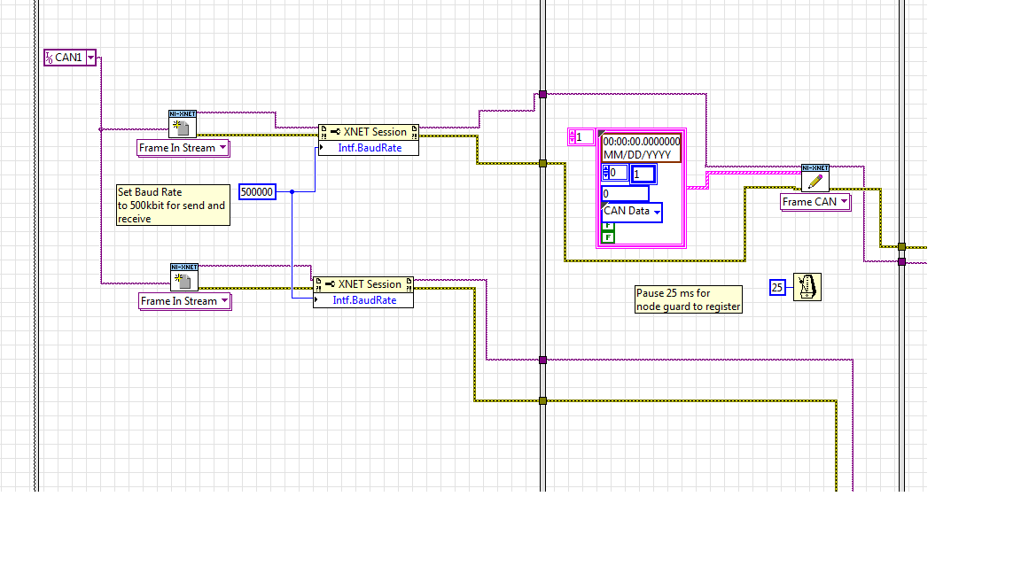

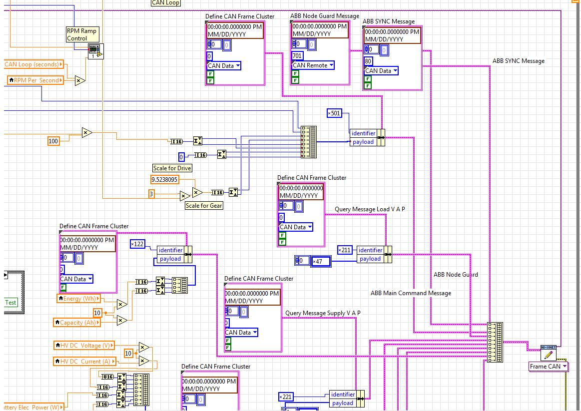

I am really happy that I can read this article because it seems like it is the similar problem that I am facing right now. I also has a really bad CAN update delay when I want to write Data on CAN bus.  I was trying to following your solusion here, use frame in single point, frame out single point. But I am not so sure that I can continue. In our labview, we use frame in/out stream(sorry the screenshot cut is wrong). But if I want to change it to frame in/out single point, it will show an error saying: mising wiring on NI-XNET block.
In our labview, we use a big sequence loop. So what in saw in the 1st pic I attached is the first sequence, then in the 2nd sequence we had a Frame Can write frame. Then in the 3rd one, which is in the 2nd pic, it shows the CAN write frame that contain a lot of message that I would like to write on CAN bus.
The problem here is sometimes the CAN loop takes 0.3s(I use a shift register in the 3rd sequence showing CAN loop time) to update which is too low for me to use Vector Canalyzer to record data.
In your article it said I need to 'Frame in single point' for my reads, and 'Frame out single point' for my writes. I do not know where I can do this. Also how to make it cycling timing. And I did not have any database in NI-XNET database editor. Do I need to build it there?
Thank you so much.
