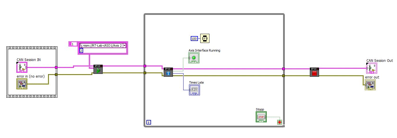

Hello Thierry,
the screenshot below shows the Code which sets the Axis Interface of Soft-Motion in running-mode:
 If the "Axis Interface Running" is a indicator for the Interface in running mode.
The Input for the "Start"-VI is a constant which includes my both unbound Axis.
If I right click in my Project and select "Interactive Test Panel", i get the following Error:
The axis Interface is keeping on Running and promting no error.

Hello Benjamin,
This seems to be a user-defined error code.
In general this means that it is an error that is not "coming from LabVIEW", but rather an error that a custom application (purposely) creates and returns to you in certain conditions.
It think you should check with Maxon Motors what this used defined error is supposed to mean.

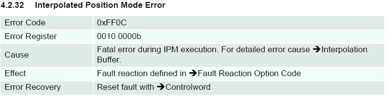

i got feedback from Maxon Motor, the answer is below.
The Error 0xFF0C is EPOS2 device error. Have a lookt at the document "EPOS2 Firmware Specification" chapter "Error Handling - Device Errors".
-> 0xFF0C: "Interpolated Postion Mode Error
For a more detailed error info, connect the EPOS Studio to the USB interface of the EPOS2 controller and have a look at:
- Status Window
- Object Dictionary -> Object 0x20C4-0x01 (Interpolation Buffer Status)
I assume its a buffer overflow, caused by a too high cycle time of the compactRIO master.
The description in the "EPOS2 Firmware Specification" can be found below.
In my programm, I do not use any Interpolated Position Mode of the EPOS2 device, so I think, that this Buffer Overflow is caused by the NI Soft Motion Interface itself.
I will contact the maxon motor support for further Information/Solution and I will try a little bit more programming, such as resetting the error after opening the Interactive test panel.
