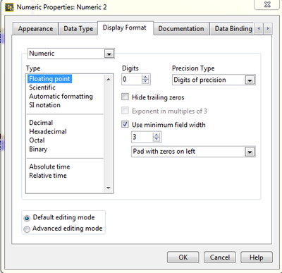

Even Change of Properties of a Numeric Control/indicator will help you.

Why use number to Hex String at all???
Use "format into string" with the correct "format string" and you are done:

Correct.  And the Number To Decimal String will fill the string width with spaces instead of 0s.  So Format Into String, or even Format Value, inside of a FOR loop would be the way to handle arrays to get what the OP is asking for.
