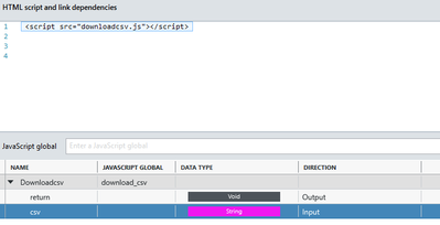

Issue - After Changing my gcomp file from "WebApp" to "RH520", my javascript/JSLI call on the block diagram stopped working.  The js function downloads data to a csv.  I changed "RH520" back to "WebApp" and it started working again.  (Perhaps the JSLI didn't have it's association updated to the new project name?)
Environment - WebApp Queued Message Handler template NXG 5.0
Steps to reproduce:
Open WebApp Queued Message Handler template
Add JSLI and link to js file
(Javascript)
function download_csv(csv) {
	console.log(csv);
    var hiddenElement = document.createElement('a');
    hiddenElement.href = 'data:text/csv;charset=utf-8,' + encodeURI(csv);
    hiddenElement.target = '_blank';
    hiddenElement.download = 'tempdata.csv';
    hiddenElement.click();
Place the downloadcsv node on the block diagram with any string as input
Run the labview program in browser so that downloadcsv is activated
NOTE: csv downloaded succesfully
Change the .gcomp name from WebApp to RH520
Run the program in browser once again
NOTE: csv does not download
Expected: csv would still download after changing project name

Could you attach an example that reproduces the behavior? It would be helpful to include the entire project (lvproject, gcomp, .cache folder, etc).
Milan
(2,419 Views)
Hey MilanR
Attached is the project.  You'll notice that if you change the WebApp.gcomp to for example "BugApp.gcomp", you'll see that when running the program in browser; the "download" button will cause a "Dynamic: Stop Event" in the event loop.  I have trouble tracking down what triggers it.  I didn't notice this is what was happening when I first came across the issue.
Changing the gcomp back to "WebApp.gcomp" resolves the issue
Studying for CLA.
LabVIEW, inherit from social media habits!
(2,411 Views)
Accepted by topic author CDuck
Hi CDuck,
Thank you for sharing an example! I was able to reproduce the behavior and created Bug 1122047 to track it. My first impression is that it looks like you hit a case where the NXG cache is not updated when the Web Application Component is renamed. We will look into the bug more but a workaround seems to be:
1) Rename the component from WebApp.gcomp to BugApp.gcomp
2) Save all and close LabVIEW NXG
3) In the project folder remove the .cache directory
4) Re-open the project in LabVIEW NXG and run the BugApp.gcomp::Index.gviweb VI in the browser
Deleting the .cache directory is not a recommended / desired workflow so thank you for reporting the issue so we can look at it closer.
Milan
