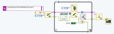

You might try adding ni.var.psp: in front of the URL. I did a quick test with the snippet below and it works as expected.
I did have to create the shared variable and process manually using Distributed System Manager. I don't think NXG offers a way to create and deploy shared variables directly.

Thanks @MichaelBlazer! It worked.
Note: For some reason it was not working initially. After I deleted the variable in NI Distributed Manager and then re-created the same variable name, it worked.
