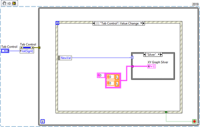

I would like to point out a performance issue in the NXG style XY Graph.  I've attached a VI that includes a comparison between the Silver style XY Graph (first tab) and the NXG style XY Graph (second tab).  Notice that the Silver graph seems reasonable (other styles are reasonable also).  You can zoom, autoscale etc.
The NXG style XY Graph performance is abysmal!  My computer grinds to a halt with this same exact dataset.  Why?
