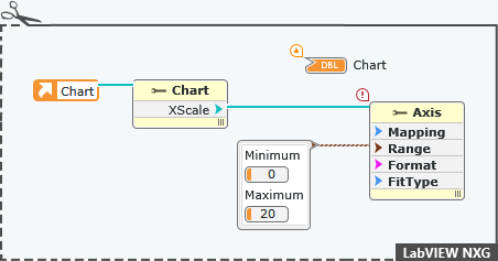

The property node for a chart has x scale as a read only and there is no offset multiplier for the x-axis.  How can I customize the x-axis of a chart in LabVIEW NXG?

Hi Danny,
You probably did not see that XScale is a reference, which is indeed read-only. Just do this:
(3,103 Views)
I'm still looking for a way to mimic the multiplier property node from regular LabVIEW to modify the numbers on the x-axis
