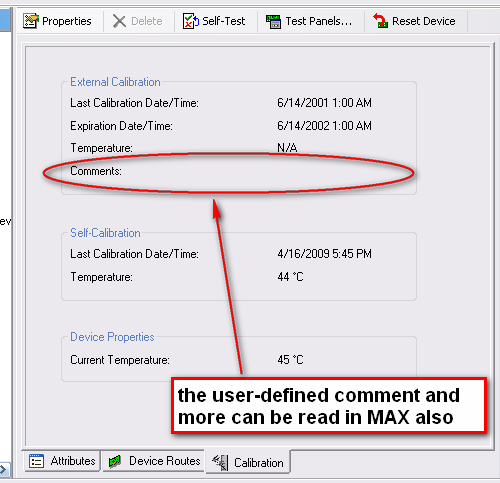

Unfortunately, there is no way to do this with these devices. The closest way to do this on a DAQ board would be to add a user-defined comment to the device when performing an external calibration (using the Cal.UserDefinedInfo property). This may not be ideal since it can only be done when performing an external calibration adjustment, and the size of the string is limited depending on the device you are using. However, this will not be an option with a USB-6008/9 such as in your application since it cannot be calibrated.
