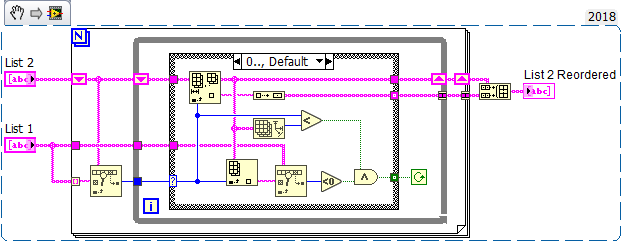

Looking for cleanest way to do this.  I have 2 lists (1D arrays of strings): List_1 and List_2.  Some items are on List_1 only, some are on List_2 only, some are on both lists.  I want to rearrange the items in List_2, such that, as much as possible, the order matches List_1.
Here's what I've come up with:
It just seems like there ought to be a better way.

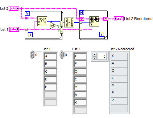

OK, I misunderstood.
Here's my solution that keeps all unique elements of list_2 in original order, but sorts the items that also occur in list 1 according to list 1.

Not quite what I'm looking for.  Since Q is not in List_1, it should be placed after E, because E is in List_1 and Q is after E in List_2.
But X is also not in list 1, so why should it stay in first position?

Accepted by topic author paul_cardinale
I'd use a simple keyed sort.
Here's my thinking: When an item is not in List_1, its final position (in the rearranged list) should be relative to whatever initially preceded it.  Since nothing precedes X in List_2, nothing should precede it in the rearranged list.
