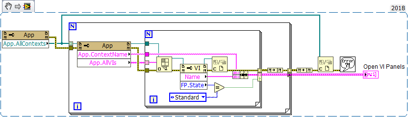

The Request: I would like to have a list of all labVIEW windows open, and accessible from an array. In other words, when you press 'Ctrl + Shift+W' I would like the Strings in the 'Title' column to be in an array for me to read.
The Goal: I'm trying to get a list of all open labview VI's to log in a bug report, but I need the list to span ALL application instances. I don't know how else to tackle this, I would be extremely grateful if you all had any clues.

Is this what you mean?

I may have to go into work tomorrow just to try this.  Ty for the quick response! I'll let you know if it works ASAP

Paul this does what I need it to do, thank you for putting it together for me. Unfortunately labVIEW has only just implemented that App.AllContexts property node in LV 18: https://labviewwiki.org/wiki/Application_class/Application.All_Contexts_property
Looks like I have some justification to get my team to upgrade from 2017. Thanks again.

It's a brown node, so you need proper 'secret' in ifile keys. Or use quick drop and use CTRL+SHIFT+B with the exact right text (App.AllContexts).
Or use the snippet of course.
You could simply not tell this and move from 2017 😁.

1) select a property node
2) CTRL+Space, "Application", CTRL+B
3) CTRL+Space, "App.AllContexts", CTRL+SHIFT+B
