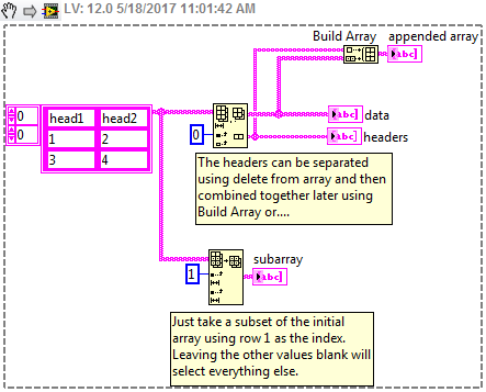

Array size returns an array if there is more than one dimension.
Also you don't need to delete from array and index array in order to get the headers separate from the data.  See below.
