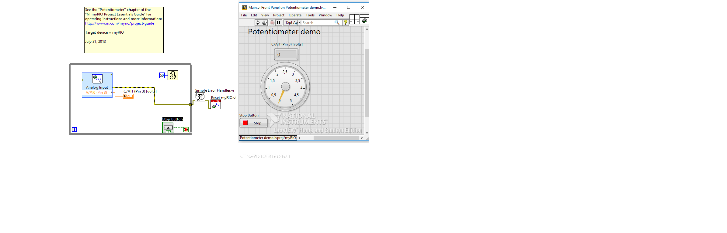

Good evening everyone and Hope y'all have a Nice 2017. But guys, please, someone help me with this. Today I was studying labView, and at the final of my day I got real problems with my physical AI's at my Rio. The thing is, My Rio is not reading Analog inputs anymore. I created digital indicators for all my AI, and I came acroos with smth. All my IO's was receiving 0,25 V at the graphs. Expect for my AI1, that was showing 0.75 V. I tried some simple Test like the potentiometer and even the Photoeletric test. None of them I got succes. I couldn't get 0-5 V not even with the potenciometer.

But yeah man. I've checked the getting started interface and everything is ok.
I even made the acellerometer and the button test to see if it's working.
Everything is ok. I gotta check the digital inputs, but any of My AI's is reading.

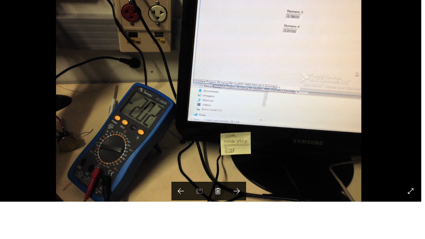

I'm gonna attach you some files for u to see my tests. At this pic u can see real measurement and Virtual one.
As I told. I'm not reading this 2V
(3,882 Views)

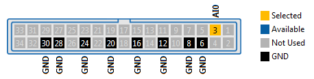

Hello fideias,
Can you try with a very simple VI to take one sample in the first analog input channel, as this one:
connected in
Then check if the value read in the terminal is the same as the one you have in your multimeter. Try this a couple of times, what values should you read and which are you actually reading?

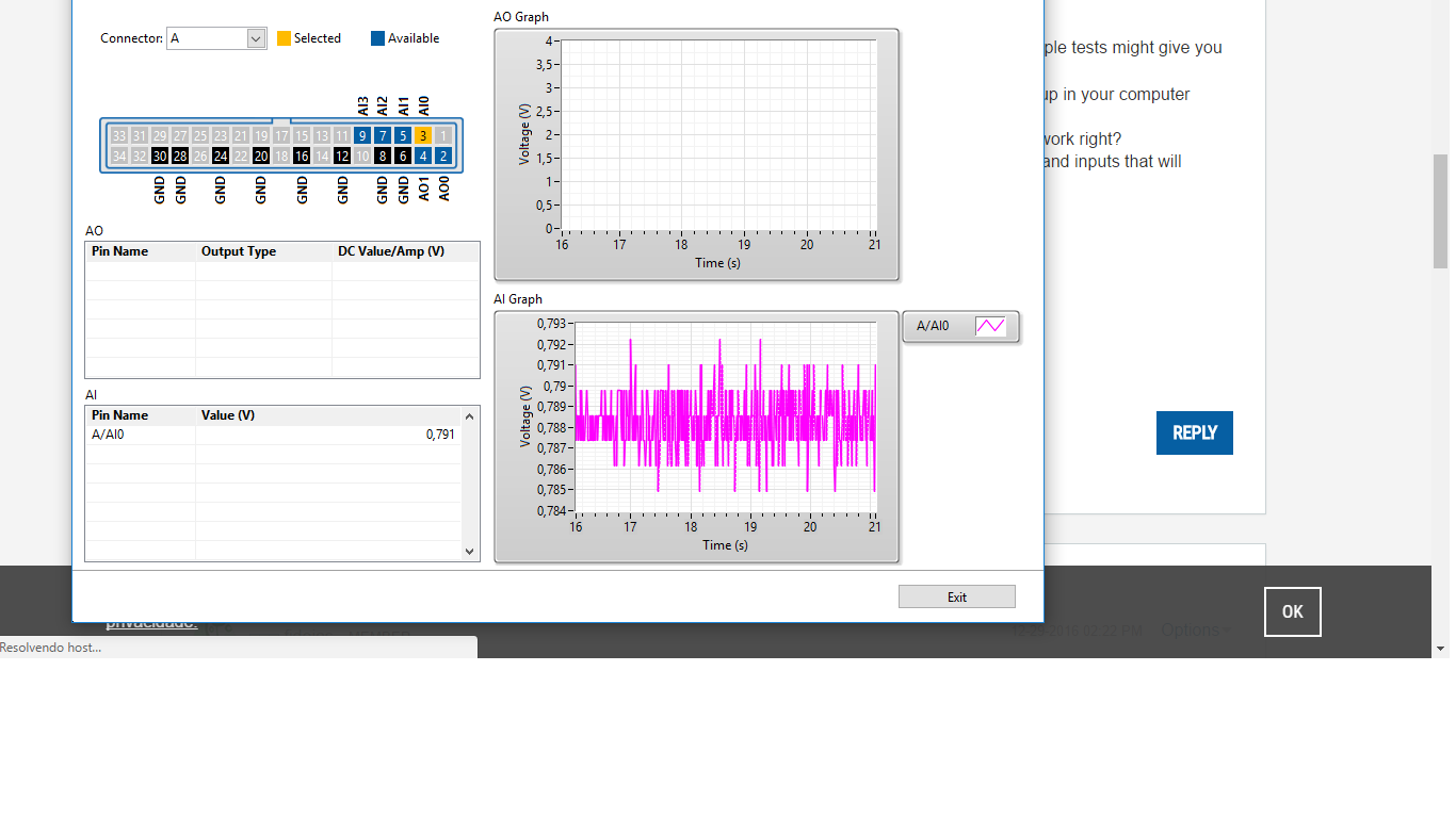

Oscar,
Good Morning. Didn't work too man.
Is this wave form normal?
Floating like this, does it usually happens with AI's?
And the thing is: The rest of my AI's showing something like 0,28V. But same waveform.
Is that normal? That distortion? I think it's not the code. Maybe I changed smth at NI Max or compiling FPGA?
(3,857 Views)
