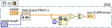

The array is aquired online instead of a given array. And the sum of difference is not calculated by all elements, it is calculated by the latest n elements. At each sample time, I get one result. I am still working on it. Thank you.
(4,183 Views)
Is this what do you mean? (Bg is a subvi to obtain data from device at sampling times). Thank you.

Accepted by topic author chalkwu
Hi chalkwu,
why do you put the whole array into the shift registers?
(4,163 Views)
Hi Knight. GerdW,
I thought there should have some subvi with the function storing certain length of some squence data. And that is Data Queue. Thank you very much.
