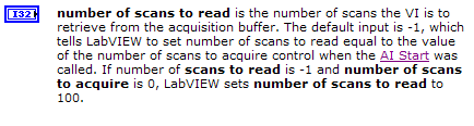

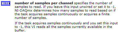

Assuming that the Traditional DAQ and DAQmx code are screenshots from separate VIs, I believe that the following parameter of the read functions in each driver would account for the different behavior that you are seeing (you have both set to -1):
Traditional DAQ:
 DAQmx:
So, when you give DAQmx Read a -1 for "number of samples per channel" when running a Continuous task, the effect is that it will return whatever data is available at the time DAQmx Read is called.  In your case this is immediately after the task is started so there very well could be 0 samples available in the buffer.  I'd imagine that you would see data if you change the value of this parameter from -1 to the actual number of samples that you want to read.
