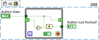

I just built a VI to do this with the FRC team I mentor; unfortunately, that code is on a team laptop and I don't have it. The idea is you use a while loop with an uninitialized shift register. The shift register maintains the previous state of the button. Each time you call the VI, you check if the previous button state was false and the current state is true, meaning the user just pushed the joystick button. If so, do whatever you needed to do. If you make this into its own VI and use it in several locations, make sure you set the VI to be re-entrant (VI properties, Execution category) otherwise it won't work as you expect.
The image below shows a very simple version that does only what you want. We made ours more complex with a reset input and an additional output so that it could toggle (press once to turn on, press again to turn off).
(2,987 Views)
Accepted by topic author JJay
