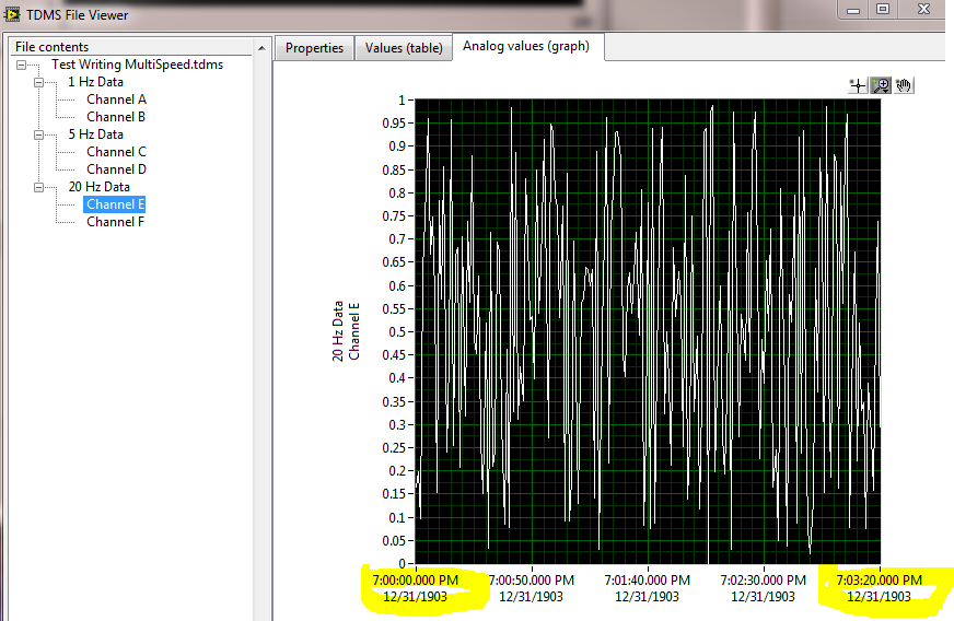

In the viewer, the propertes ("wf_start_time",  "wf_increment") are seen correctly attached to the groups, but they are ignored by the graph tab in the viewer.
But here the time on the X-axis is starting at T0, over 100 years ago:
Another channel shows the same X-axis:

If I understand your description correctly, then It is a bug of TDMS File Viewer. We have found it and will fixed it in the next release. When reading a channel to waveform to show in the graph tap. we will initialize the t0 and dt  with the value of wf_start_time and wf_increment properties And it shows correctly. But If the channel doesn't have these properties, we left the t0 and dt as they were. And it is wrong.
That's exactly what I saw.  The T0 and dT were left as they were.
