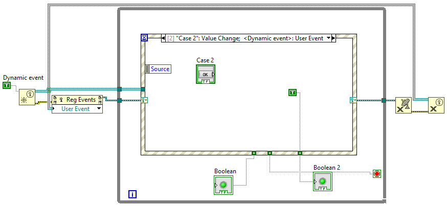

Here is the your code modified as explained by Kyle97330.
Marc Dubois

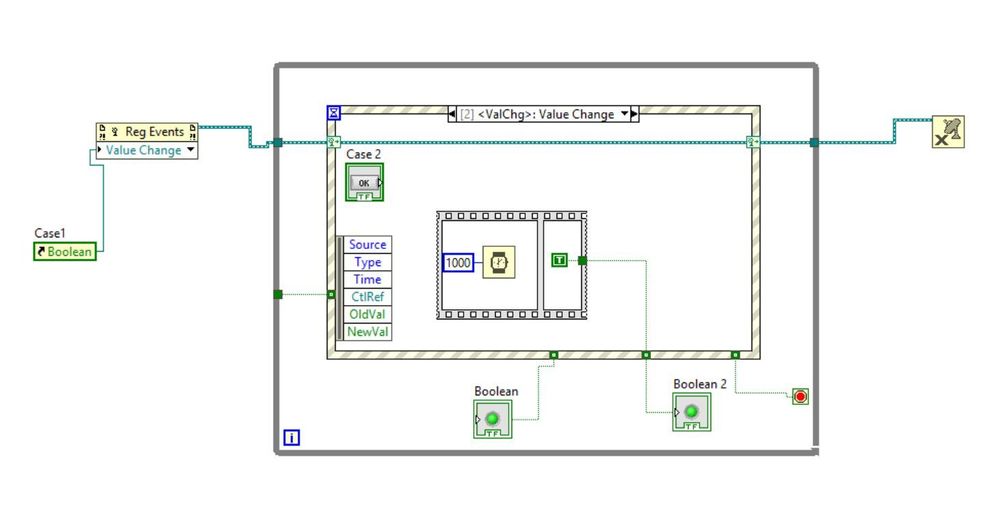

MarcDub
Thanks to you and all the others for the ideas. After I posted, I sort of figured it out and I am showing that below. I notice that your input to the  Reg Events is a little different than what I did and I'd like to understand the difference and how they would behave. I did mine by right clicking on the button in case one to get a Refnum. In my real VI I have quite a few buttons that run cases. Does your way work on any Boolean going true? I think my version might be specific to one switch.
Also, what is the difference between Unregister and Destroy? What happens if you don't include Destroy? What happens if  you don't Unregister.
Message 7 of 17
(10,686 Views)
You have registered an event directly associated with one of your controls. What you did is the equivalent of creating a value-change event for Case1 directly in the event structure. My approach was to programmatically generate an event, independent from any control. It all depends what you want to do.
When you register events, LabVIEW is creating the structure to monitor those events. When you unregister the events, you let know LabVIEW that there is no need to monitor those events anymore.
Similarly, when creating an event, LabVIEW allocates some resources for that event. It is recommended practice to destroy it whenever you are finished with it. Notice that you can register an event with more than one event structures. That is why you should unregister first then destroy the event.
It is the recommended practice to unregister and destroy but for a single event structure, it might not matter much from a point of view memory management. LabVIEW will clear out the memory upon terminating the VI.

MarcDub,
I tried your method but it doesn't seem to actually work. Maybe I missed something? I attached the VI
Mine works but I have to add an input in the Reg Event VI for each button. It would be nice if one input for any button going True triggers the VI I want triggered.
