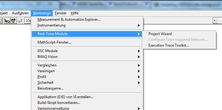

Is this the real time module?
Yan.

If you have the Real-Time toolkit, you will see the "Real-Time" palette when you look at the block diagram palettes.  It will also show up in Measurement and Automation Explorer under Software if you expand LabVIEW (in your case, LabVIEW 2010 f2).
