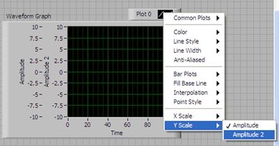

For more than one Y scale:
1. Right-click the Y scale and select "Duplicate Scale"
2. Click on the Plot you want for that scale, go to "Y Scale" and select the one you just made (renamed as appropriate).
You can also choose "Swap Sides" to put a scale onto the right side of the chart/graph.
Jim

Hi grasman,
have you read jcarmodys message on how to apply a plot to a y-scale?
See attachment on how to plot 2 curves onto one xy-graph and to attach each plot to one scale. I strictly followed the context help of the graph and jcarmodys message...
I would also suggest to stay away from express vis: they tend to make more problems than provide help. You are more involved in type conversions (to/from DDT) - using simple wires gives you just more control over whats happening in your code!

Hi grasman,
the problem is in several points:
1) change your plot style to show points instead of lines
2) you only plot one point per curve because of the way the arrays are generated (initialize arrays of size 1, a simple build array node will do here too)
3) switch on auto-scale
You have to collect the data in shift registers to have a history - graphs only plot what they are wired with, charts have their own history buffer...
