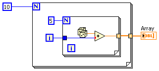

ok this is what i got, now the problem is that i want both for loops to  go to the same output array
Message 3 of 8
(4,373 Views)
edit:  ok this is what i got, now the problem is that i want both for loops to  go to the same output array
(forgot to add the file)

your almost there...did not realize this was homework? this one is a freebee Smiley Wink

ok i understand thats how you get a 2d array. But what if i wanted to have 2 of the for loop going to 1 array. I need the frist row to be a ramdom number between 0-1, the 2nd row to be 1-2, the 3rd row 3-4 ,the 4th row 4-5 ,the 5th row 5-6
the 6th row 6-7 ,the 8th row 7-8, the 9th row 8-9 and, the 10th row 9-10.

 its seem so obvious now. i was stuck on that for like 2 hours. thank you
