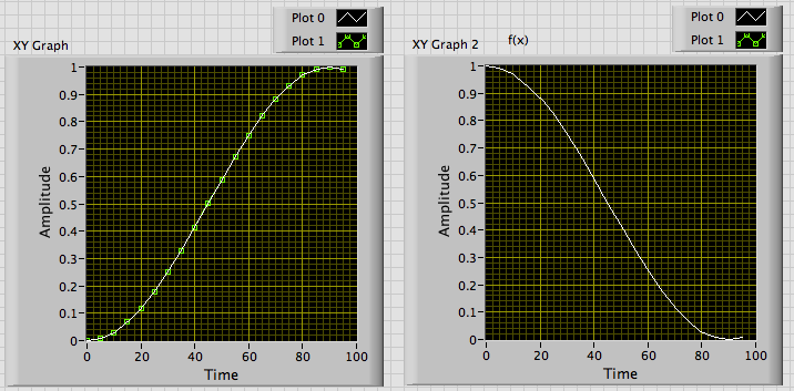

I wonder about your formula.  When I implement the formula with LV functions I get a curve which is different from your data plot.
With two of the initial parameters set to zero the 0.97 or 0.98 coefficient does not even apply on the first iteration.  Changing the initial value of c from 0 to 0.1 will generate a good fit.
The best fit parameters are 1, -1, 3.2..., -1.  These are a long way from your initial guess. If you change the formula to 1-(original formula), then it works well with the original initial parameters and the best fit parameters are the same as the initial parameters.
A good formula and a good initial guess are important to getting a good fit.

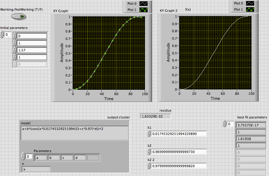

I just implemented the formula you fed to the fitting VI.  I did not look at the calculation you did for the "raw" data.
Consider: The first value of x is zero. To get a phase shift of ~pi/2 a good first guess for c is 1.57.  With any value close to that it gives a good fit for either choice of c.

The Lev-Mar algorithm sometimes does not do well at fitting the phase or frequency of sinusoidal models.  Internally it uses derivatives to get the next approximation to the parameters. The derivative of cos(c) with respect to c = -sin(c) but that does not do much to force a change in c.  What this means is that a good initial estimate for c may be more important than for some of the other parameters.
Possibly something as simple as a pi/2 phase shift if the residue is large might work.
