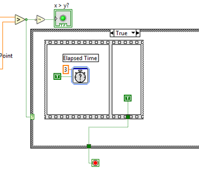

Your wait prevents the loop from spinning. Use e.g. the elapsed time express VI.
Message 2 of 9
(5,305 Views)
Tried the Elapsed Time Express VI, but got the same result
Message 3 of 9
(5,288 Views)
You should really look at the help and examples. In your code, the elapsed time express VI just gets initialized, then the VI stops. You need to initialize when the condition occurs the first time, then continue spinning the loop until the express VI returns that that time has elapsed.
Also note that there is no reason for the sequence structure. It makes no difference!

Here's how to correctly use the elapsed time express VI.
(I prefer non-express Vis, though 😉 )

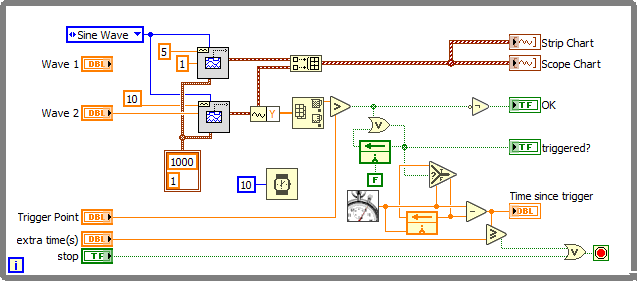

Here's a cleand up version of my first code.
  • You only need to build the array once, you can branch later.
  • Try to avoid all these duplicate diagram constants.
  • Feedback nodes are easier here than shift registers.
  • When attaching code, fill all controls with typical default values.
  • etc.

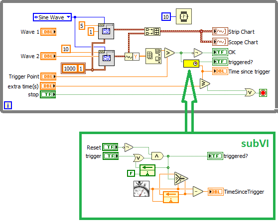

Of course you would wrap the entire thing into a resettable subVI, such as follows:
(Leave as non-reentrant if multiple instances should trigger a global condition or make it reentrant so each instance has it's own condition. Your choice.)
