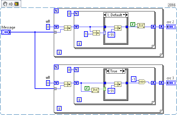

Here.  There are probably some optimizations available, but here's both a literal translation of the logic and a slight tweak to give you a starting point to explore benchmarking with different bit-manipulation functions.

With code very similar to Kevin's I found that the speed is dependent on the size of the message. For small messages the formula node is faster. With messages of 255 elements the native code is almost 10 times faster. With messages longer than 255 elements the formula node hangs. (Loop counters i and j are U8).

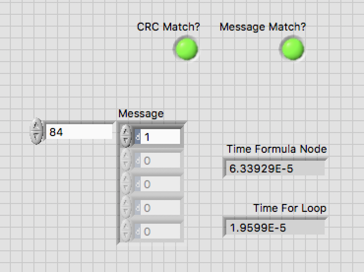

At a message length of 85 I find the native LV code about 3 times faster than the formula node.
